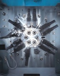

V-shaped tool carrier arrangements on the Index MS22C give shops the freedom to run any tool any where. Two new machine models optimize part-processing times, says manufacturer Index Traub (www.index-usa.com). According to Index, ...
According to Index, the MS22C is a low-cost viable alternative to using 6-axis or 8-axis cam-controlled multispindle automatics, or sliding and fixed headstock automatics, for processing medium-complex turned parts from tough-to-machine materials. What makes this possible is an offering of 62 axes maximum, 12 CNC compound slides, Y axes and synchronous spindles.
A special spindle drum houses the MS22C's six spindles, each with their own individual motor with independent speed control and left, right and stop C-axis capability. Each spindle runs up to 10,000 rpm and provides 18 Nm of torque.
Because the MS22's tool carriers/slides are arranged in a V shape, two CNC slides simultaneously can work on one spindle. Each of the machine's potential 12 slides can perform operations such as O.D., I.D., boring or rotating tool work. Shops are not locked in to running one kind of tool in one position because there is no set order as to where to run what tool on the MS22C. Only the toolholder determines the type of machining. This tool-position flexibility plays a key role in optimizing part processing times, according to Index.
MC22C spindles handle barstock up to 22 mm (0.88 in.), and there is a synchronized spindle with a separate slide that holds up to six backworking tools. Four of these tools can be driven.
