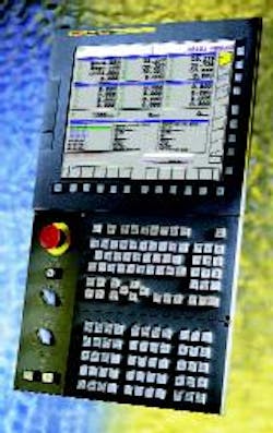

The Series 30i-Model A CNC controls up to 40 independent axes and executes up to 10 independent NC part programs simultaneously. According to the manufacturer, the 30i's interpolation cycle is 8 as fast as a conventional interpolation cycle, improving qua
Jan. 1, 2004
The Series 30i-Model A CNC controls up to 40 independent axes and executes up to 10 independent NC part programs simultaneously. According to the manufacturer, the 30i's interpolation cycle is 8 as fast as a conventional interpolation cycle, improving quality and part cycle time.
Nanometer interpolation (1/1,000,000 mm) is done for CNC internal operations and for all machining for smooth and precise motor control. The CNC's lookahead feature now handles 1,000 blocks, while processing time is 0.4 ms.
