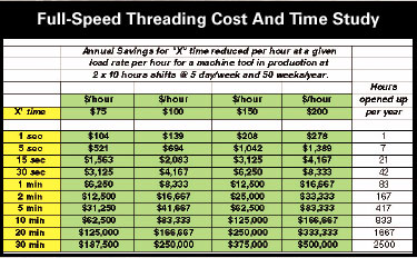

When asked about actual cost savings, Shepherd says, "The savings can be huge. For example, if you are machining cast iron at 60 to 70 sfm, we can probably improve that up to 250 sfm. If the cost of having that machine just sitting there is a typical $100 per hour and I can cut just 10 minutes per hour off that, the customer will save about $83,000 per year amortized over two shifts and free up about 830 hours of machine time."

"If you are machining cast iron at 60 to 70 sfm, we can probably improve that up to 250 sfm. If the cost of having that machine just sitting there is a typical $100 per hour and I can cut just $10 per hour off that, the customer will save about $83,000 per year amortized over two shifts and free up about 830 hours of machine time."
