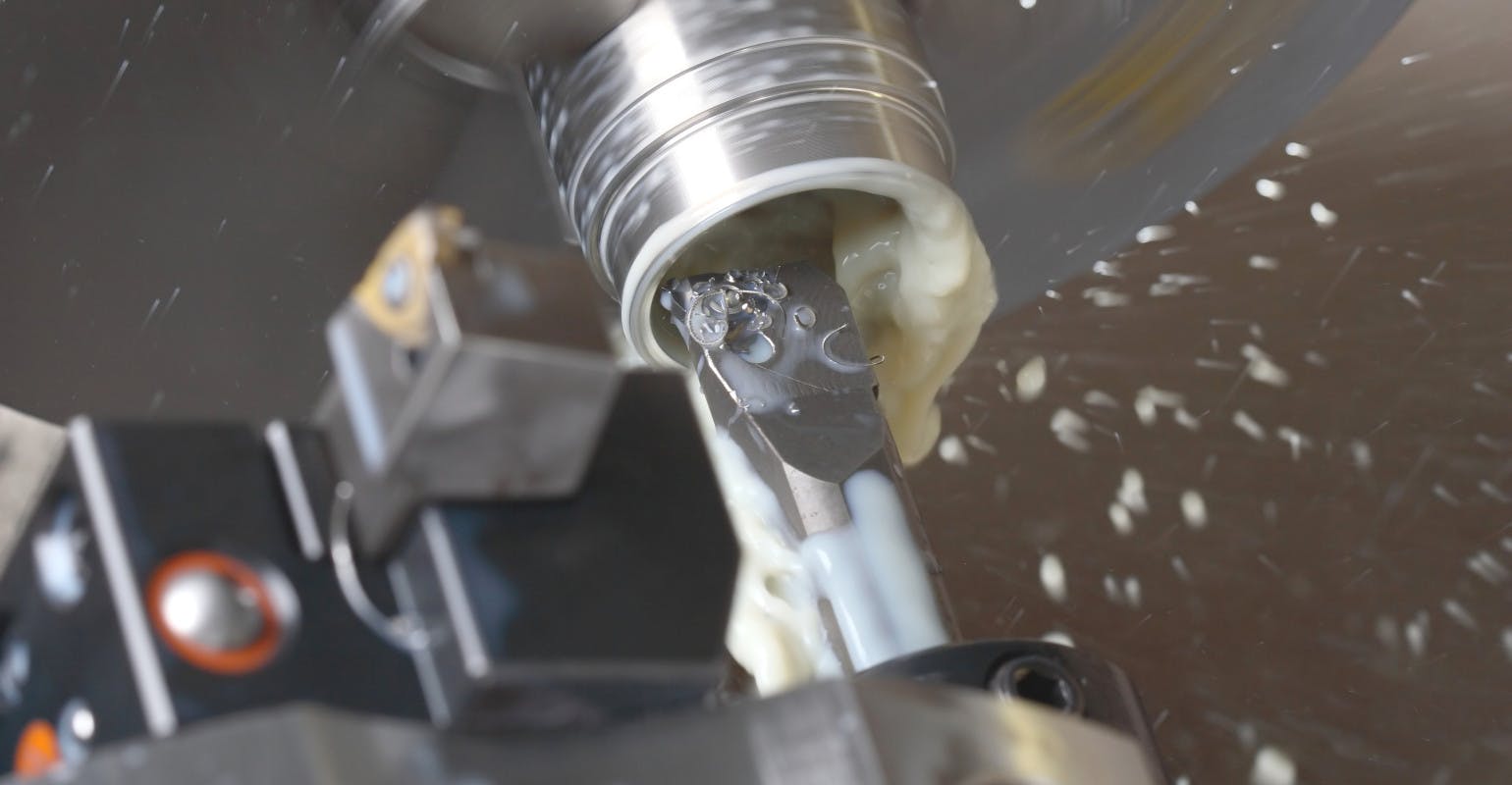

In high-throughput CNC machining, failure rarely announces itself with drama. It may begin quietly with coolant mist infiltrating a gripper body, abrasive swarf accumulating around seals, or a subtle drop in repeatability that slowly erodes cycle stability. Then, almost abruptly, a production cell that once ran with lean precision becomes a maintenance bottleneck.
For manufacturers scaling automation for CNC machine tending, this is not an edge case. It is the operating reality of machining envelopes where coolant pressure, chip load, and particulate density are constant stressors. In those situations, end-of-arm tooling (EOAT) becomes the primary defense against robotic downtime and catastrophic process drift.
Hidden costs in the machining envelope
CNC machining operations expose automation to coolant mist, high-pressure fluids and swarf, which gradually degrade EOAT performance through contamination, seal wear, and chip buildup. While supporting machining efficiency, these conditions also introduce hidden waste that disrupts consistency, increases downtime, and destabilizes takt time in CNC machine tending automation.
