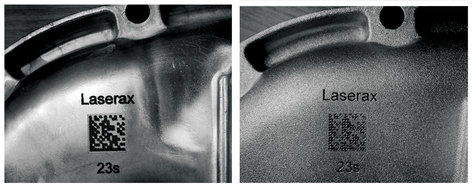

A developer of industrial laser technologies (for cleaning, marking, cutting, and welding) has introduced a patent-pending process for product marking that it describes as “shotblast-resistant” — such that high-volume producers of automotive castings can provide the product traceability that OEMs expect without altering their processing and handling practices.
Laserax reportedly devoted three years of research and product development with metalcasters before introducing the shotblast-resistant marking system in October. The result is a system that allows the part manufacturers to apply permanent identifiers directly on the casting. The developer credited two metalcasters — Cascade Diecasting Group and Mercury Marine — with the project’s success.

According to Laserax, imprinting the cast parts using its patent-pending laser technology ensures the survivability of the codes, and allows the markings to maintain greater contrast than standard marking processes achieve.

To maintain the legibility of the DMC throughout the shotblast process, it is necessary to protect the dark areas of the codes. Otherwise, the high and low points in the mark would be rounded or dulled, thus reducing the darkness of the marks.
The Laserax patent-pending process helps to preserve those high and low points from the blast media. Pockets are embedded into the metal surface, which creates walls around each dark cell. So, the marks maintain a better contrast level than those created with standard laser marking.
