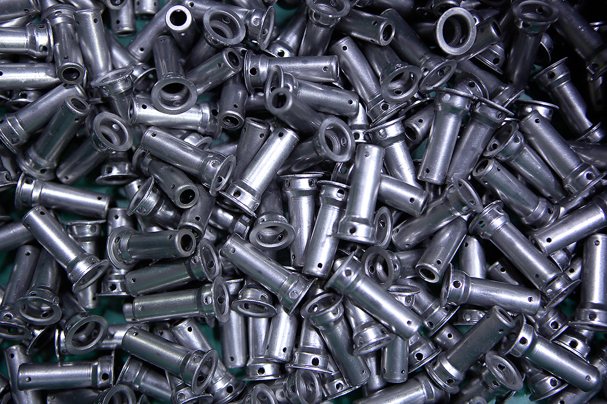

Parke pointed to one recent part, a spring cup that required a novel solution.  Like many deep-drawn parts, it was flared at the top with a narrower diameter for the body.  The part specification included piercing a hole in each of the “stepped” sections, leaving a heavy burr.

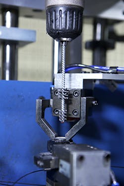

The self-centering, self-aligning, and self-compensating Flex-Hone features abrasive "globules" attached to flexible filaments along a central shaft and can be used in any rotating spindle. Commonly known as the ball hone, the Flex-Hone is used in CNC machining for deburring and surface finishing of metal parts with cylindrical bores or through-holes.  Although it is often used with automated equipment, the abrasive tool also can be used with a drill.

So, Parke contacted BRM and explained to the engineering solutions team that this job required a “stepped” hone that would work with the specific dimensions of the part. “With the part being stepped, I was not sure if we would need a custom brush or what the ideal choice would be,” Parke explained.
BRM is a developer and manufacturer, and it has the insights and resources to customized hones for unique applications.  This may include custom sizes – from extremely large diameter to miniature – as well as unique configurations, such as tapered or stepped.  According the Parke, the developers responded quickly with a tool that met Precision Stamping’s need.
Now, after the parts are stamped and cleaned, they are transferred to a nest for piercing.  When that is completed, they are moved to another nest, where a stepped Flex-Hone is inserted and rotated using an automated pneumatic drill.  The same operation is repeated in the opposite direction to ensure maximum deburring as well as maximize brush life.  The part then drops through an escapement in the machine as finished goods.
Since Precision Stamping started using the custom Flex-Hone, Parke said they have experienced a steady increase in production output.  In one six-hour period, operators were able to run 8,000 pieces and not a single part needed additional deburring. “The Flex-Hone is definitely helping us keep costs down by not having to send parts out for thermal deburring,” he said. “If you don’t have to do that, you’ve saved all the part-handling time and saved all that money.”
Parke said that, all told, the improvements have been significant. “Now we can deburr in-house and they look ten times better than what we were getting before after the thermal deburring.”
