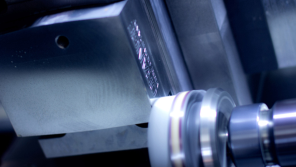

It was then that Sun discovered a new abrasive tool from Brush Research Manufacturing, the abrasive technology that invented the Flex-Hone Tool in use worldwide. BRM’s new line of NamPower abrasive disc brushes are designed to allow CNC operators to automate deburring process and deliver an ideal surface finish, in a single operation.
Orange Vise Co., which manufactures vises for CNC machines, the combination of automated deburring and surface finishing eliminated several time-consuming, labor-intensive processes.
“We started using the NamPower brushes for deburring, but quickly discovered they provided a really nice surface finish,” Sun said.
Composed of flexible abrasive nylon filaments bonded to a fiber reinforced thermoplastic base, the NamPower abrasive disc brushes contain a unique combination of both ceramic and silicon carbide abrasive. These abrasive filaments work like flexible files, conforming to part contours, wiping and filing across part edges and surfaces to deliver maximum burr removal rates along with an ideal surface finish.

Sun had a choice of brushes from BRM, between the product’s two available fill configurations: the Dot Style, for general purpose deburring and surface finishing; and the Turbine Style, which has a higher density fill for more aggressively deburring.
To achieve the smoothest finish possible and approximate the ground surfaces of the CNC vise, Sun said he selected the Dot style brush and intentionally reduced the spindle speed. He was immediately pleased with the results.
“The surface finish was good enough that we were actually blending it with our ground finishes,” he reported. “With large surfaces that required multiple passes, there were no visible blends. The whole thing looked like it was done in one pass.
“Needless to say, the brushes sped up the process quite a bit,” Sun added.

In addition to deburring, Eric said Orange Vise does some engraving on the vice jaws, using a ball end mill. Although the engraving on the underside of the vice doesn’t require deburring, Orange Vise wanted finer engraving on the top. For this, they used a 45-degree V-bit that created burrs.
To remove the burrs, the options were either to grind them out or to use the NamPower brush. Sun opted for the latter.
“Grinding would be so much more work. With the brushes it really doesn’t take any extra effort at all. It adds maybe 30 seconds to the process,” he said.
