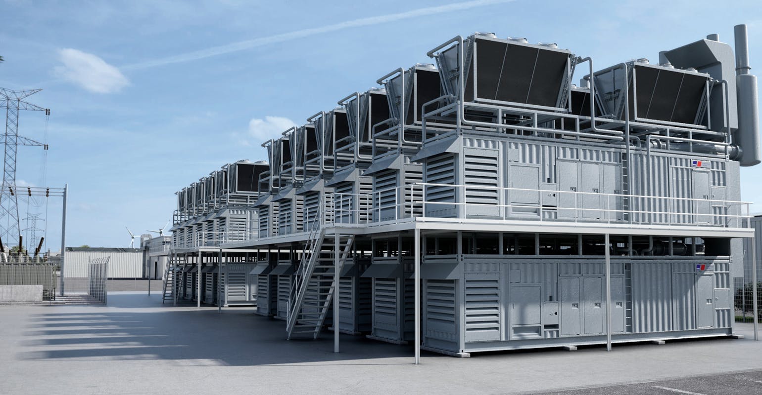

Rolls-Royce has developed a modular natural-gas power plant for use by utilities or data centers. The preconfigured, factory-tested modules consisting of 10, 20, and 30 megawatts units, each supplying five to several hundred gigawatts of electricity. The plants are supplied as back-up units, and may be used to compensate for fluctuations in the feed-in from wind and solar energy generation.
Each installation is comprised of mtu Series 4000 L64 20-cylinder generator sets, produced by Rolls-Royce subsidiary mtu Solutions.
In 2025 Rolls-Royce North America announced $75-million expansion at its Aiken, S.C., plant to increase production of Series 4000 gen set components.
The modular plants are also capable of operating with 100% hydrogen fuel, as available.
Preconfigured modules can be supplied for use within 18 months.
