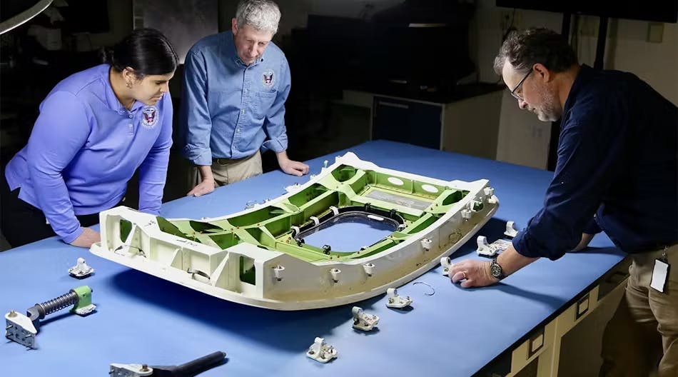

In her report, Homendy confirmed the previously reported details about the cause of the failure – principally, the fact that four critical bolts meant to secure a sidedoor panel in place in the fuselage had not been installed – and described how the failure depressurized the cabin, caused oxygen masks to drop, and sucked unsecured items out of the aircraft. Seven passengers and one crew member were injured.

The NTSB is an independent federal agency responsible for investigating civilian transportation accidents, and in a hearing on the 737 MAX incident chairwoman Homendy recapped previously reported determinations about how the jet’s sidedoor panel had been improperly bolted during the final assembly of the recently delivered aircraft, and then cleared final inspection.
"The safety deficiencies that led to this accident should have been evident to Boeing and to the FAA," Homendy said. "It's nothing short of a miracle that no one died or sustained serious physical injuries."
She described how the 737 MAX assembly procedures had no documentation for removing and reinstalling the sidedoor panel, the design element covering the aircraft emergency exit. The panel is in place when the fuselage is assembled by Spirit AeroSystems, removed by Boeing during interior outfitting of the aircraft, and then reinstalled for final assembly.
