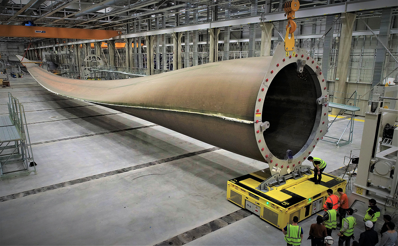

LM Wind Power has produced the world’s largest wind-turbine blade at its manufacturing operation in Cherbourg, France. The 107-meter long part is one of three that will be produced as part of a GE Renewable Energy Haliade-X 12-MW offshore turbine, the first of which will be built this summer near Rotterdam, The Netherlands.
The blade is comprised of multiple thin layers of glass-and-carbon fibers with wood, fused together with resin.
