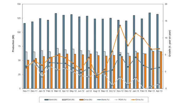

Global raw steel production declined -2.4% in April, falling to 132,116,000 metric tons from a revised total of 135,354,000 metric tons in March. The World Steel Association, the Brussels-based trade group that represents steelmakers in 63 countries, supplied the results. The April tonnage represents an improvement of 1.2% over the April 2012 results.
“Raw” describes the primary product of electric arc furnaces and basic oxygen furnaces, prior to metallurgical refining and casting into semi-finished products, such as slabs, blooms, or billets. World Steel’s monthly report totals the global carbon and carbon alloy steel output; Stainless steels and other specialty alloy steels are not included.
The April tonnage brings the 2013 global steel production total to 521,283,000 metric tons nearly 10,000 tons or 1.9% more than the four-month total for 2012.
As is typical, China led all countries in steel production during April, with 65.65 million metric tons produced, 6.9% more than the March total and 6.8% more than the April 2012 result.
For the year to date, Chinese raw steel production totals 258.1 million metric tons, 8.4% more than China’s result for the January-April 2012 period.
