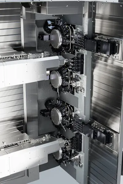

One of the debuts will be the Traub MS12-4 CNC multi-spindle machine. According to the developer, this machine effectively combines four Traub TNL12 single-spindle sliding headstock lathes into one machine with four primary spindles, four tool turrets, two or four counter spindles, and up to four Flex-WT flexible tool carriers. A flexible, modular design means that the MS12-4 can be optimized according to specific production needs.
The MS12-4 brings the low cycle times and reliably precise performance of CNC multi-spindles to applications that are poor candidates for a drum-style multi-spindle. For example, it can be difficult (or impossible) to distribute machining of a part evenly across six or eight spindles when a specialized process accounts for a disproportionate amount of cycle time. Because the stations of the MS12-4 concurrently produce fully finished parts, the machine allows optimization of a broader variety of components.
Additionally, by incorporating sliding headstocks for each of the machine’s spindles the productivity of a multi-spindle can be achieved for long, thin parts, such as bone screws and small electrical components.
