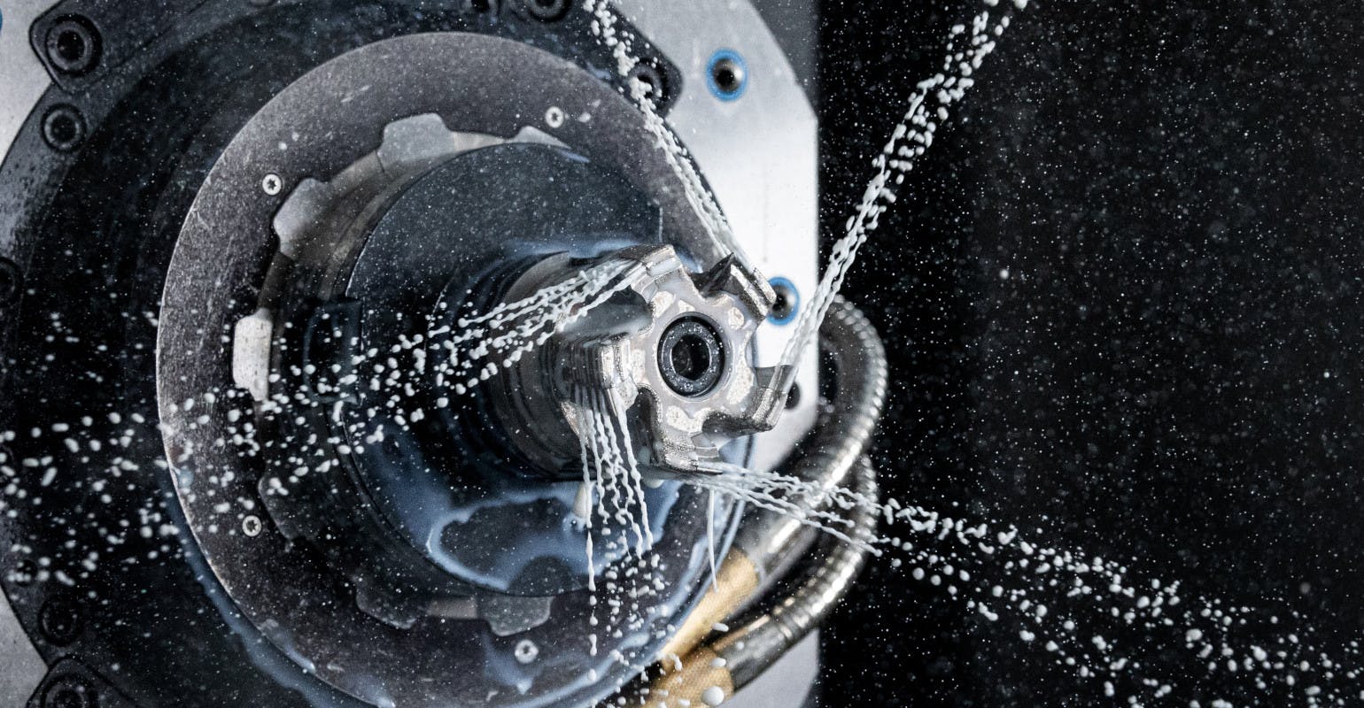

Much like the OptiLine six-flute, the MaxiMill – 211-DC was developed for heat-resistant materials like titanium and other super alloys. The milling system was created through in-house additive manufacturing with 3D-printed cooling channels. Additive processes allow the patented shoulder mill to funnel the optimum amount of coolant directly on the insert flanks. In turn, it provides process reliability when machining heat-resistant materials.
The MaxiMill – 211-DC has 60% longer tool life compared to tools with standard cooling. Further, despite the complexity of the coolant holes inside the tool body, the MaxiMill – 211-DC is compatible with standard adapters with through-coolant supply without requiring any standard coolant on the chip breaker.
