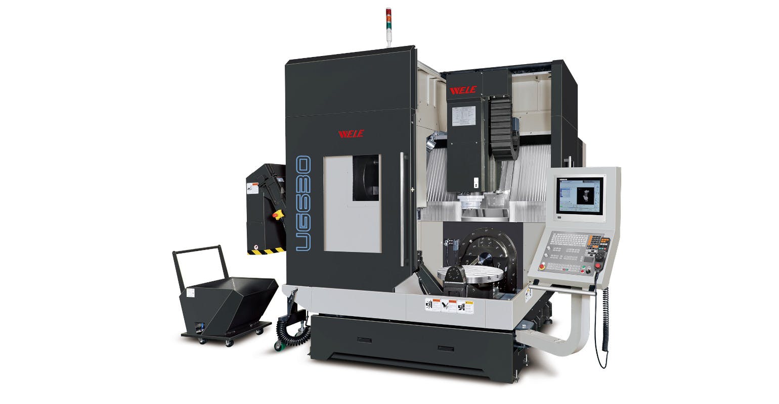

JTEKT MACHINERY is offering a new vertical machine center, the WELE UG630 VMC, featuring an advanced overhead gantry design and an integrated, high-precision trunnion rotary table, enabling more operations in a single set-up. For a variety of machining needs, including high-speed, heavy-duty, and five-axis machining, JTEKT’s complete line of vertical machining centers delivers reliable performance.
Due to a vibration-dampening Meehanite cast iron base and large precision spindle bearings, users benefit from increased rigidity while sustaining higher load capacities.
The UG630 includes a Heidenhain TNC 640 CNC plus touch screen display to optimize machining capabilities.
The UG630 VMC is designed for X-axis travel of 640 mm / 25.1 in.; Y-axis travel (spindle head) of 520 mm / 20.4 in.; and Z-axis travel of 460 mm / 18.1 in. the rotating range of the C-axis is a full 360°. The swiveling range of the B-axis is -50 deg / +110 deg, maximizing tool access to surfaces of the workpiece.
The rapid feed rate (X,Y,Z) is 40 (m/min) / 914 (in/min).
The workpiece clamping area is 650 mm / 25.5 in.
A 60-pocket, chain-type automatic tool changer provides all the CAT 40 Big Plus tools needed to complete workpieces in a single clamping. The UG 630 also includes a Blum probe and tool setter package.
Machining speed and power are delivered through a built-in, type 38-hp spindle with a speed of 15000 rpm.
Known for designing and building rigid and dependable machining solutions, WELE machinery is manufactured under strict quality control. As a production standard, all metal-to-metal contact points are hand-scraped, which ensures the highest levels of long-term accuracy and true geometry.
