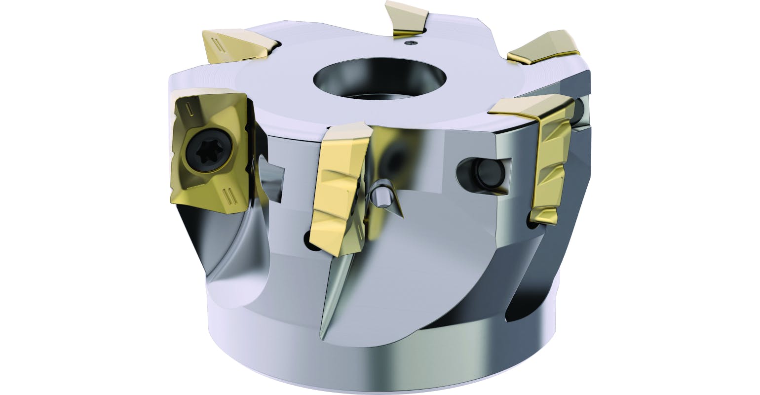

SECO TOOLS introduced two new chip splitter milling inserts that lower the stress on both the machine and cutting tool, improving the stability of the milling process. The Turbo 12 and 18 chip splitter inserts for Seco’s Turbo cutters – available in five grades for both square shoulder and helical milling cutters – significantly reduce chatter, vibration and stress on manufacturing equipment.
The Turbo 12 and 18 chip splitter inserts incorporate grooves on both of their cutting edges to minimize chip size and reduce cutting forces without reducing cutting data and depth of cut. By keeping chips as small as possible, shops lessen the risk of chip jamming, which improves process security and allows for more effective machining of deep pockets.
Product managers Magnus Engdahl and Michael Davies spearheaded the team that developed the inserts. “The Turbo 12 and 18 chip splitter milling inserts apply to various machining applications and materials,” Engdahl said.
“The versatility of the inserts makes them suitable for a wide range of industry segments and materials, providing customers with flexibility,” Davies added.
Hard-to-reach part features may pose challenges for machine programmers and operators, and even the toughest combinations of machine and tool may not overcome the problem of long overhangs. Seco chip splitter inserts overcome these challenges by effectively evacuating chips from deep pockets for improved chip flow. Plus, Turbo 12 and 18 chip splitter inserts reduce chatter commonly associated with long-reach applications, resulting in longer tool life and better surface finishes.
Because of their stability and ability to reduce cutting forces, Turbo 12 and 18 chip splitter inserts give machine shops the much needed process security and reliability required for effective unattended machining operations. As a result, shops increase output while also minimizing stress on the machine and tool.
