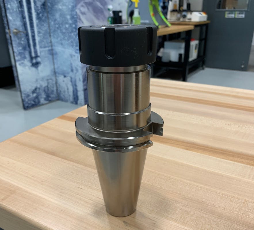

The PG48 tool holder accommodates cutters up to 40 mm (1.500 in.) in diameter for total indicated runout of under 3 microns, for tool lengths up to 3x diameter.
Swiss tooling company REGO-FIX its powRgrip (PG) tooling system specifically for large-diameter tools and aggressive machining applications. The recently released PG48 tool holder accommodates cutters up to 40 mm (1.500 in.) in diameter and ensures total indicated runout (T.I.R.) of under 3 microns (0.0001 in.) for tool lengths up to 3x diameter.
Additionally, the holder provides length pre-adjustment with a repeat accuracy of less than 10 microns (0.0004 in.)  And it incorporates a special cap nut from the proven REGO-FIX secuRgrip tool locking system to effectively eliminate cutter pullout in heavy material removal applications.
The powRgrip system uses a taper-to-taper, press-fit collet holding design that creates a vibration-damping gap to interrupt the strength and severity of vibration waves. Three components make up the powRgrip system: holders, collets and press-fit assembly mounting units.
Because of its tool size capability, the PG48 holders require the use of a brand-new press-fit assembly unit called the PGS 48. The PGS 48 is an automatic hydraulic press that generates up to 15 tons of force to press and remove collets from the holders and is a single-series machine designed only for PG48.
Toolsetting is accomplished in no more than 10 seconds without heat or hydraulics used in other tool clamping systems. PowRgrip technology allows tools to be used immediately after the clamping cycle concludes without the limitations and tool-life compromises of other systems.
