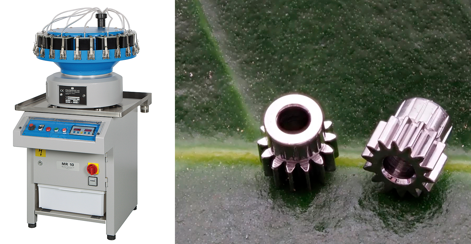

The Polyservice micro vortex vibrators MR10 and D3/D4 are mainly used for deburring and rounding of punched or turned small and micro parts. With these machines it is also possible to machine cross holes, slots, indentations and other contours.
With the satellite centrifugal vibratory grinding machines Polysat1 and Polysat5, the smallest parts are deburred with high grinding power and surfaces are polished to a high gloss. Even very hard materials such as technical ceramics or hard metal can be processed with this technology.
