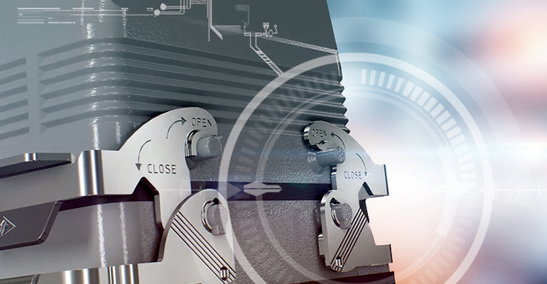

MENCOM introduced the V-TYPE lever for rectangular connectors in response to the increasingly diverse and specialized performance requirements for securing the connections against severe vibration in harsh manufacturing environments. The V-TYPE lever is distinct from other types of levers by its closing mechanism consisting of two hinged elements that are pivoted on the housing. This composite movement allows the levers to move over the pins on the housing with an initial rotational movement and push down to engage the locking mechanism, which results in a tight seal with a high degree of protection (IP66/IP67/IP69 according to EN 60529).
Constructed of stainless steel, the V-TYPE lever features a secure latch to prevent unintentional release, and the lack of plastic parts provides several benefits including increased durability against impact, corrosion from oil, chemicals, and high temperatures. The distinct vertical pressure-based locking mechanism minimizes friction on the pegs, resulting in reduced wear and substantially enhanced longevity, even with frequent use.
Thanks to a spring-free, compact, and sturdy design, the new lever is well-suited for industrial applications constrained by limited space and vibrations. This secure locking mechanism prevents accidental opening as well, particularly in situations where connectors are installed vertically and the weight of the heavy cable installed on the bottom could force the lever to open.
The V-TYPE lever's fixing flanges are engineered to be identical to those of traditional models, ensuring that new housings with the V-TYPE can replace the old version without affecting interchangeability or requiring changes to dimensions, flanges, or mounting positions. The V-TYPE lever is offered in both bulkhead and surface-mounted configurations, with a single lever available for size 44.27 and double levers available for sizes 57.27, 77.27, and 104.27.
