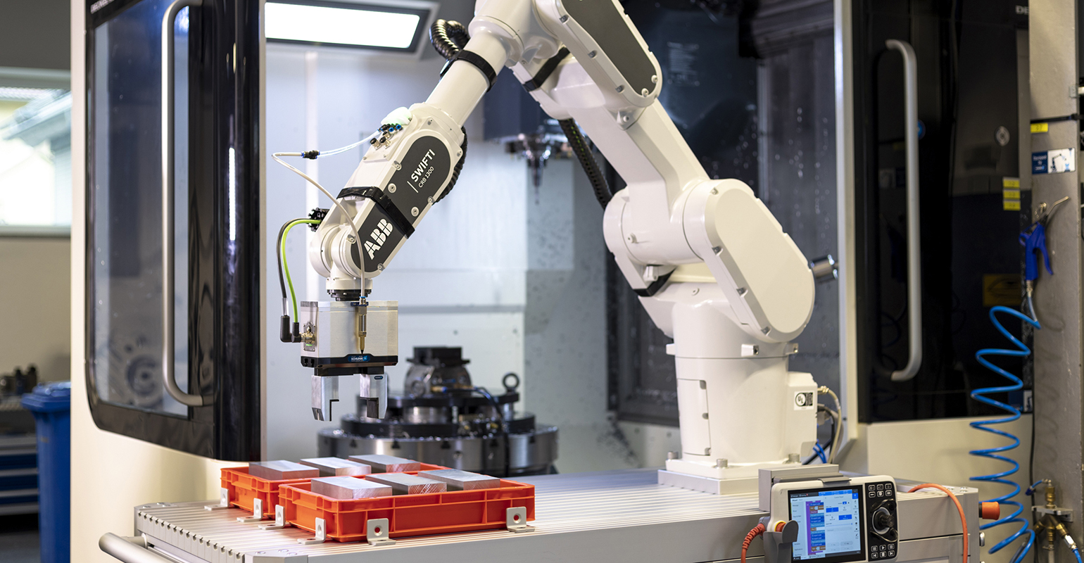

ABB introduced a new collaborative robot – cobot, called SWIFTI™ CRB 1300 – that it says bridges the gap between industrial and collaborative robots. Combining speed and accuracy with load-handling capability of up to 11 kg, the SWIFTI CRB 1300 can be used in various production and product handling applications, from machine tending and palletizing to pick-and-place and screwdriving.

With protection against dust and moisture (up to IP67), it can also be used in demanding environments, making it ideal for machine tending applications.
