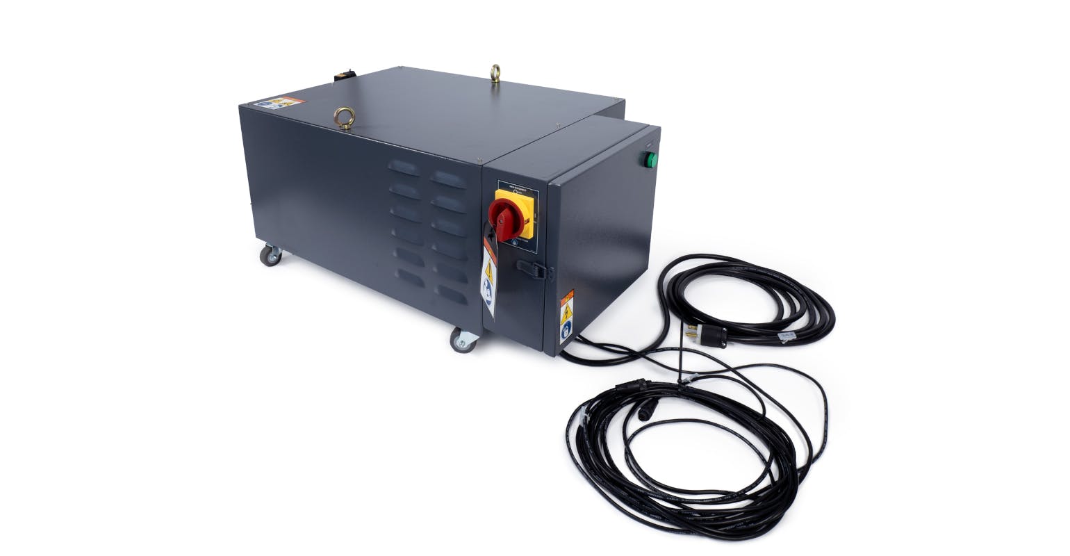

Delivering clean air and superior filtration
The Tormach Mist Collector is engineered to maintain a cleaner workspace by capturing and filtering out vaporized coolant and airborne particles before they become a problem. It features a centrifugal fan that provides exceptional attraction and centrifugal force to effectively collect mist and vaporized liquids. The system’s two-stage filtration design maximizes its ability to filter oil and mist particles, while a stainless-steel bottom strainer recycles oil and lubricant back into the system to enhance efficiency and reduce waste.
“Any time you're moving coolant, there’s going to be a significant amount of vapor released into the air that can decrease air quality and pose potential health risks for operators,” Zelickman said. “We’re launching the Mist Collector alongside the Through-Spindle Coolant Kit because the dual approach not only keeps the shop environment cleaner and safer for the operators but also helps maintain the longevity of the machinery itself.”
Additional features of the Mist Collector include:
  • Pressure gauge: Monitors internal filter status to ensure optimal performance.
  • Quiet operation: The high-performance motor operates at just 65 dB, offering low noise, minimal vibration and a long operational lifetime.
  • User-friendly design: Features a simple push-button switch for manual control and easy, toolless filter access and removal. The stainless-steel filters are also washable for easy maintenance.
With specifications that include a 1/2 HP motor, 420 cfm airflow and compact dimensions (395mm x 400mm x 650mm), the Tormach Mist Collector requires 220V at 2.5A with a recommended 10A breaker and is an essential addition to any machining operation.
