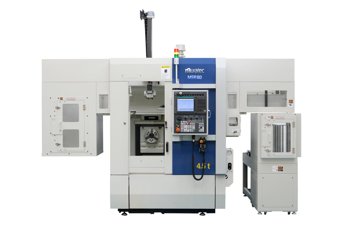

MURATEC MACHINERY USA is planning the North American launch of its MSR60 single-spindle CNC turning center with Y-axis milling capabilities for multitasking machining at IMTS 2024, at booth 338844. With a directly coupled 8,000 rpm live tool spindle motor, this machine is engineered to deliver high-speed precision in a small footprint, and maximum productivity through integrated built-in gantry loader automation.
The MSR60’s compact design and advanced automation capabilities allow for a space-saving layout that maximizes productivity per unit of floor space. Because it integrates milling and turning, this machine is ideal for high-mix, low-volume production environments. Like the larger MWR120, a front-facing horizontal twin spindle turning center, the MSR60 introduces Y-axis and milling capabilities previously unavailable on a single-spindle machine.
With automation at its core, the MSR60 is a CNC turning center with front-facing 6-inch/8-inch chucks equipped with a Y-axis. It has a single 10-station turret, an X-axis stroke of 240 mm, a Y-axis stroke of ±60 mm, a Z-axis stroke of 200 mm, and a maximum spindle speed of 6,000 revolutions per minute.
The MSR60’s width is 1,555 mm, and its depth is 2,350 mm, half the size of the MWR120, but it has twice the range of motion or stroke typical for a turning machine its size.

Maximum spindle utilization: Advanced built-in automation, rapid shutter-to-shutter time, reduced spindle acceleration-deceleration, and minimized turret index time make it the most efficient machine in its size range for profitable production runs.
Efficient gantry loading: For seamless automation, the MSR60’s optional gantry loader can handle a diverse range of workpiece varieties, enabling unattended cell and system activity. It is also available with a dual gantry loader for an even faster, more efficient run time.
Compact design: Integrates compact design, advanced automation, oversized NSK guideways, and robust Muratec spindles to maximize productivity, cutting capabilities, and workpiece tolerances in a space-saving layout.
User-friendly operation: The MSR60 streamlines setup and maintenance to maximize spindle uptime with easy work holding and turret access. Its standard Fanuc 31i control, featuring Manual Guide I, simplifies programming and automation setup for rapid NC program creation.
