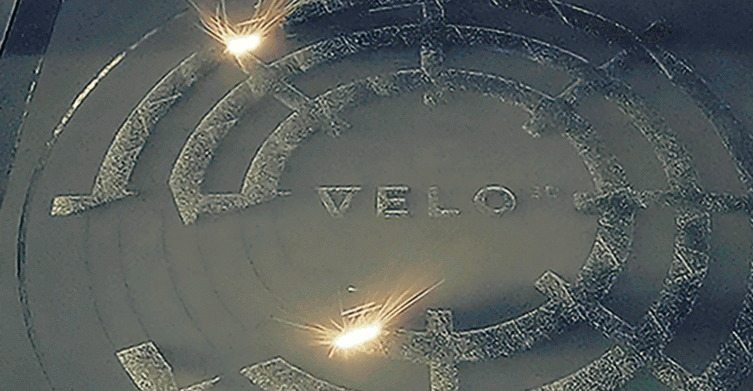

Industries like aerospace and automotive rely increasingly on metal additive manufacturing (AM) operations to create critical parts expeditiously – weight-saving components with complex geometries, different material properties, and minimal set-up times. To construct each part, 3D printers melt, or partially melt, ultra-fine layers of metal powder on build plates. After each metal part is finished, it is cut away from the build plate.
However, a notable production bottleneck in metal AM (or metal 3D printing) is that any residual metal must be removed entirely before the build plate can be re-used. This requires precisely resurfacing the build plate so that is completely flat, level, and correctly textured prior to printing the next part. Unfortunately, standard surfacing methods present significant drawbacks and have become a production bottleneck in the metal AM process.
