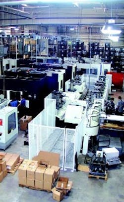

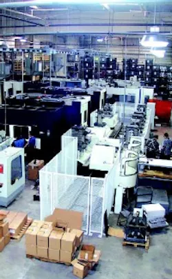

A cylinder head machining line in Edelbrock's shop

In the machining facilities are fifteen automated CNC machining centers that include six Mori Seiki MH63 twin pallet machines, and seven fully automated CNC vertical machining centers with four-and fiveaxis capabilities. Two cylinder head machining cells use three Makino A88 4-Axis units. In another work cell, two smaller Makino A55s produce water pumps, throttle bodies and other small articles. A dedicated Transfer Line machine can machine a small-block Chevy intake manifold every 2.5 minutes. All machines are linked together by an automated pallet loader. Laughs Vic, "There's no machines here with a handle, like we had years ago. Everything's done with pushbuttons now."
