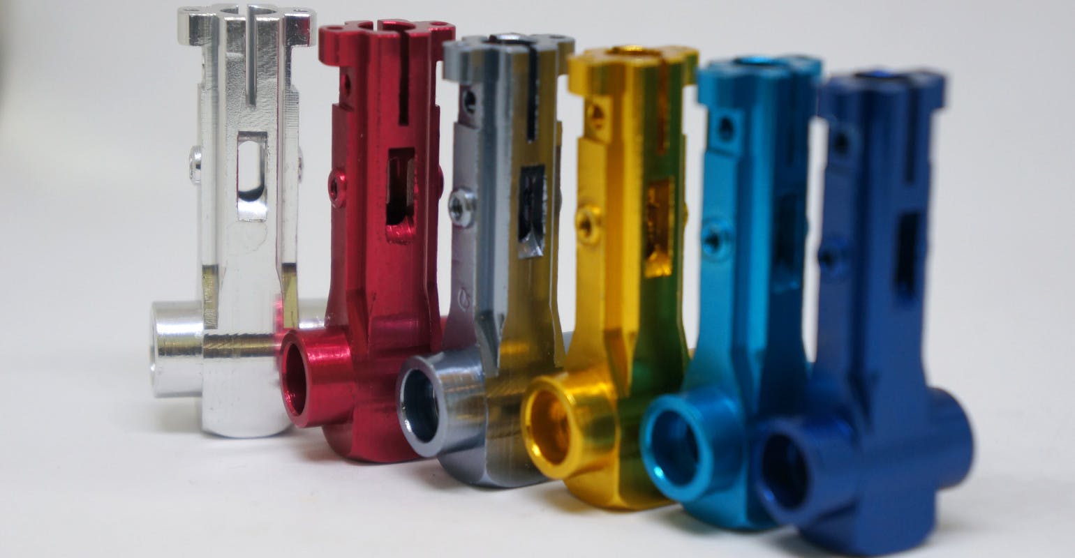

Although finishing mistakes can be costly, the process is essential: unfinished metal is vulnerable to chemicals, moisture, ultraviolet radiation, and corrosion. There are dozens of types of metal finishing. Powder coating is among the most popular for fabrication projects, as it provides uniform coverage, even on complex shapes.
Additive finishes add a layer to a part via spraying, electrostatic discharge or dipping, increasing the outside dimensions. Common application processes include painting, plating and powder coating. Penetrative coatings - applied via anodizing or chromate conversion coating - fully integrate into the substrate, requiring smaller surface finish tolerance adjustments.
In precision machining processes, the toolpaths are generated based on a CAD or CAM model of the final part. If the surface coating’s thickness is not accounted for the added material can easily push the part's dimensions outside of the acceptable range.
For instance, after coating a precisely machined hole can become smaller, while an external dimension becomes larger. To ensure accuracy, simulation software must differentiate between coatings that sit on the surface and those that penetrate the substrate.
