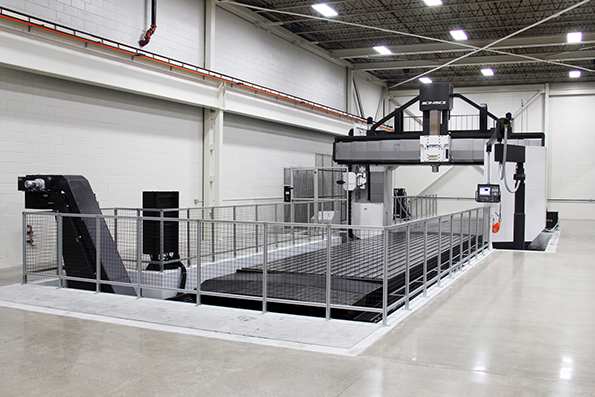

Unisig — a Menomonee Falls, Wis. manufacturer of deep-hole drilling systems— recently added more large-scale production capacity by installing a new Okuma machine described as “the largest double-column machine of its type in North America.” It’s a fast-production route for processing complex components involved in assembling Unisig’s large-sized deep-hole drilling systems.
The Okuma MCR-A5CII-35x100 double-column machining center has multiple cutting heads that allow it to process five sides of a large part in a single setup. This means that Unisig will be able to manufacture high-quality parts for its systems more quickly, and at a lower cost than by cutting the parts in a more standard vertical machine.
Anthony Fettig, CEO at Unisig, said the MCR-A5CII-35x100 advances Unisig’s considerable engineering capabilities and promotes greater productivity as it addresses rising demand for its deep-hole drilling systems. “This machine allows us to keep semi-finished part production in-house and decreases labor intensive finishing work.”
The MCR-A5CII-35x100 is a high-speed machining center with compact auto loading/unloading attachments for true five-sided machining. Its rigid double-column construction will help Unisig achieve tight part tolerances that are required for the large-dimension systems it manufactures.
The Okuma machine has a 118x394-in. table; 61-ton weight capacity; and a 6,000-rpm 50-taper spindle to promote speedy production of large parts.
Safe and efficient part handling is effected by a radio-controlled, Konecranes® 50-ton bridge-style crane with a 40-foot span and 205-in. clearance (17-ft. 1 in.) To prepare for installing the new machine, Unisig modified its shop with a deep, specially engineered foundation that weighs 650 tons and has helical piers in the ground to support the combined weight of the machine and the 50-ton crane.
