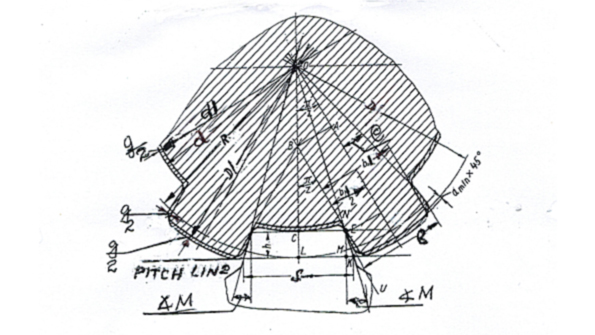

One of the more impotent features of the roughing hob for milling roughing straight-sided splines is the angle of the trapezia of the teeth of this hob. We can produce the trapezia easily on the thread-grinding machine, using abrasive trapezia wheel. After milling, the roughing straight-sided spline will appear as a rectangle with two curves on the two sides. This allowance on the splines, after heat treatment, is easy to grind on the spline-grinding machine.
According to Figure 1:
	1.  MK/CL = tgM = MK/h,
	2.  MK = S/2-CE = MK = S/2-LM,
	3.  CE = CBxtg(p/Z) = ((d/2-b/2/sin(p/z))xtg(p/z) =
	         1/2((d - b/sin(p/z))xtg(p/z) =
	         1/2((dxtg(p/z)-b/cos(p/z)),
	          p=3.14158
	4.  MK = 1/2((S-dxtg(p/z) + b/cos(p/z))
	5.  tgM =  ((S-dxtg(p/z) + b/cos(p/z))/2xh.   MLG-A.
6. After calculating angle M of trapezia teeth. We produce a drawing of the spline shaft and teeth (see Fig.1).
7. Then, we need to make a graphic check by running the teeth about the shaft. The roughing spline will look to be rectangular, with curves on two sides of the of the rectangle. Tool-designers will be able to determine how well this is running.
The allowance for curves illustrates the size of the allowance and picture of curves. A tool designer can change the angle of trapezia to provide good distribution of the allowance.
Now, we present the algorithm for calculating the angle of trapezia teeth for roughing hobs:
	      (for spline shaft) for z = 6.
	      D1 = 28mm - diameter outside of spline shaft.
	      d1 = 23mm - inside diameter of spline.
	      b1= 6mm - spline thickness.
	      z = 6 - number of splines.
	      g = 0.4mm - grinding allowance.
	      a = 0.3mm-size of chamber.
	              for z* = 8
	      D1= 48mm, d1 = 42mm, b1 = 8mm, g = 0.4mm, a = 0.3mm.
	      D = D1-2 x a, 28-2x0.3=27.4,48-2x0.3=47.4,
	                      FOR Z = 6   /   FOR Z* = 8
	      d = d1+g,      23+0.4 = 23.4 / 42+0.4=42.4*,
	          all  sizes  in  mm.
	      b = b1+g,     6+0.4= 6.4,  /   8+0.4=8.4*,
        Pitch circle radius of the spline shaft
	         R  =  Sq.Root ((D/2) x  (D/2) — 0.75 x (b/2) x (b/2))
	         R =13.4167, /   R* =23.4192,
	         spline angle   sin@ = b/2xR
	         sin@= 6.4/2x13.4167, /  sin@*=8.4/2x23.4192
	         sin@=0.2385087       /  sin@*=0.1793400
	         @ = 13.798539 degree/ @* = 10.331320 degree,
	        Hob thickness tooth on the pitch
	         S = 2xRx(p/z-0.0174533x@),
	         S = 2x13.4167x(3.141592/6-0.0174533x13.798539) =
	                               7.5876.  /
	         S* = 2x23.4192x(3.141592/8-0.0174533x10.331320) =
	                                     = 9.947697.
	                                   h = R - d/2
	                                   h = 13.4167 -23.4/2 = 1.7167 /
	                                   h* = 23.4192 - 42.4/2 = 2.2192.
      tgM = ((S-dxtg(p/z)+ b/cos(p/z))/2xh, MLG - A .
	      tgM = ((7.5876-23.4xtg(3.141592/6) +
	                    +6.4/cos (3.141592/6))/2x1.7167 =
	                  0.427474, angle M = 23.145471 degr.
	                                      for z = 6,
	                  tgM* = ((9.947697-42.4xtg(3.141592/8) +
	                +8.4/cos(3.141592/8))/2x2.2192 =
	                = 0.332788,  angle M*=18.406866 degr.,
	                                        for z*= 8.
	     tg ((3.141592/6) x 57.3degr.) = tg(30degr) = 0.5777350,
	     cos((3.141592/6) x 57.3degr. = cos(30degr) = 0.866025.
