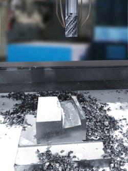

Fives Cincinnati director of technical sales Randy Von Moll described the impact of the design in performance: "This is the stiffest five-axis profiler we’ve ever seen in action, able to make these demanding cuts in titanium with ease. The machine peeled off perfect '6-shaped' chips with no chatter or sign of structural instability.
The profiler achieved its record setting MRR during test cutting, prior to delivery to the machine buyer.
“The part finish was excellent and it was a remarkable demonstration that exceeded our highest expectations," Von Moll added.
