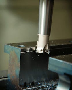

The general setup for finish-milling a deep slot in hardened S7 tool steel at River City Manufacturing and Machining, Winona, MN. With the switch to an Ingersoll Form-MasterV backdraft cutter that reduces contact area between the insert and the workpiece, the shop eliminated sudden insert failures, quadrupled edge life, doubled throughput. The process became secure enough to run “lights out” machining.

Ingersoll Form-MasterV backdraft cutter presents less contact area to the workpiece, so it can run at much higher feeds, speeds, and depths of cut -- and still reduce cutting forces. Only the insert corner radius contacts the work, not an entire side.
So, the search focused on tips with the same diameter as before but with a cutting action that would withstand higher feeds and speeds, yet minimize cutting forces. The solution: (1) start with a Form-MasterV backdraft cutter, with insert geometries that reduce the contact area between insert and workpiece; then, (2) run it much faster.
“Solely based on the throughput, the increased feed and speed would at least offset the reduction in cutting surface area,” said Lubinski. “So, the part should run at least as fast as before without overloading the insert to the point of fracture.”
They ran a trial on a single part, taking off the 0.020 inches per side in two passes. “The first pass is to get rid of the extra-hard crust characteristic of a heat treated part; the second is to bring the slot into exact size and finish,” said Hilton.
Here is the takeaway from the trial. With the previous 1-inch Hi-PosQuad end mill, the parameters were 1,400 RPM, 18 IPM, 0.005 in. DOC. The part took 20 hours to complete and required at least one indexing stoppage due to sudden, unpredictable edge fracture. With the Form-MasterV backdraft cutter, the comparable numbers are 2,600, 60, and 0.010, leading to a 4-hour cycle time. Most important, the inserts last through two full parts; the failure mechanism is gradual, totally predictable edge wear.
