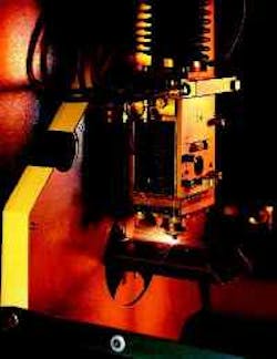

Like its predecessor, the LT651 laser tube-cutting system, only faster, the LT652 also automates processing of round, square, rectangular, and oval tube stock.
With an LT651 or LT652 system, shops can laser cut tubular parts to length, profile end shapes, produce any shape of opening in tube walls, and add locating features to streamline assembly.

The Lasertube LT651 laser tube-cutting system, from BLM-ADIGE USA Corp., Wixom, Mich., automatically processes round, square, rectangular, and oval tube stock — cutting it to length, profiling end shapes, and producing any shape of opening in the tube walls. In addition to eliminating the need for secondary machines, the LT651, according to its manufacturer, reduces labor up to 75%, eliminates the need for hard tooling that usually takes months to obtain, and slashes downstream assembly costs. Shops with the system have improved part quality and tolerances, added self-locating features to reduce the need for fixtures during assembly, and have easily incorporated robotic welding into their fabrication processes.

Because it comes preset, the LT651 accepts a special laser-beam focusing head with a capacitive sensor to automatically maintain a constant focal distance from the wall of the tube being processed, regardless of deformities or imperfections. This ensures a quality cut and eliminates collisions. The focusing head accommodates interchangeable lenses from 3.75 to 7.5-in. focal lengths. Changeover takes 10 sec, and the lenses withstand pressures up to 25 bar. The system operates on a choice of three assist gases selected from the CNC. A proportional valve lets users adjust the working pressure of two gases.
