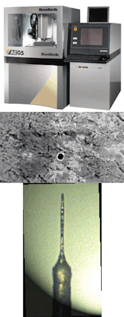

A Sodick AE05 Nano EDMed a 2.9-micron hole using a 4.8-micron electrode.
Sodick’s AE05 Nano EDM has established itself as a world record holder by machining a 2.9-micron-diameter hole using a 4.8-micron-diameter tungsten electrode, reported the company. This staggering achievement results from the machine’s completely contact-free Z-axis motion.
A pneumatic static bearing makes for ultraprecise movements in increments as small as 1 nanometer and works in conjunction with coreless linear motors for rapid response. As with all Sodick (www.sodick.com) linear machines, motors are maintenance-free and ensure zero backlash.
A built-in CCD camera gives users easy and precise measuring without changing setups. The camera magnifies to X 3,500 for viewing 1-micron details as 3.5-mm images.
Application industries for the AE05 Nano include ink-jet nozzle, optical electronics and medical. Like all high-precision EDM machines, the AE05 Nano should be installed in a temperature-controlled environment. However, to avoid further thermal influences, Sodick has housed the machine inside a full cabinet and incorporated a special temperature-control system for the machine body surface to eliminate adverse thermal effects from negligible motor heat, ambient temperature fluctuations and even the machine’s operator.
