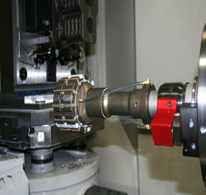

The Bates CNC hone tool and air gage. Bates manufacturers and supports hone tooling and abrasive products used in bore finishing and honing applications worldwide, and it specializes in products for use on dedicated hone machines (any make, any model) or flexible, CNC machines.
The Bates Precision Air Gage System (PAGS) allows live, on-board air gauging of the cylinder bores as they are honed.

To meet these objectives, Bates engineered and built multiple precision honing tools ranging in diameter from 2.500 to 6.000 cm, designed to fit in CAT 50 holders and to function within the control platform of a horizontal machining center. The majority of these tools use the Bates Precision Air Gage System (PAGS), which allows live, on-board air gauging of the cylinder bores as they are honed.
