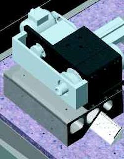

The Axtrusion concept uses linear motors at an inclined plane to preload air bearings arranged to provide elastic averaging and high pitch, roll, and yaw stiffness.

The L/T pairs a PC-based CNC with "Axtrusion" actuator/bearing technology (so called because it appears as if the axis could be extruded). Essentially, air bearings ride on two intersecting perpendicular planes for simple and precise linear motion, while a linear motor at an inclined plane preloads the bearings. These two planes represent the most accurate and lowest-cost geometry to guide linear motion. And by placing the motor at a specific position and angle with respect to the air-bearing pads, any desired distribution of preload force is obtained.
The grinder takes advantage of the powerful attractive force of open-faced linear motors. This force, which is typically 5 the axial force with which the motors actually push an axis, can so heavily load conventional rolling-element or sliding-contact linear bearings that they heat excessively and quickly wear out.
To remedy this situation, many other builders configure two open-face motors back to back or use an ironless core motor. But this arrangement results in a more complex geometry, which escalates the cost of the machine. Instead, the L/T grinder uses this magnetic force to hold down the bearings, eliminating the need for an underside "keeper" rail and, thus, simplifying machine design. In addition, the magnetic force makes the L/T system inherently well preloaded and stable even in the presence of large externally applied forces that might induce pitch, yaw, or roll.
Using the motor's attractive force for preloading maintains air-bearing stiffness and damping, even when the machine is heavily loaded. The Axtrusion configuration also eliminates the need for costly and delicate wraparound preload mechanisms and lets the entire machine be essentially made from simple planar surfaces. Because one can virtually extrude an axis from simple planar surfaces to a desired length, ballscrews and linear bearings no longer constrain machine design.
