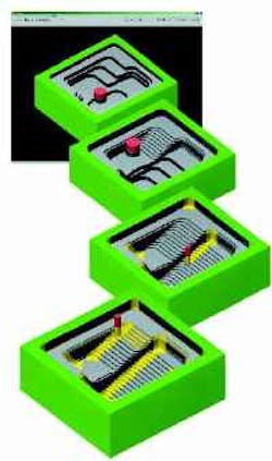

Rather than programming and processing one toolpath at a time, Surfware's Step Reduction Milling technology simultaneously generates all toolpaths. This method, says Surfware, slashes rough machining time up to 50% and decreases NC programming time as much as 90%.

In the SRM mold-roughing process, the majority of programming time is spent up front, defining tools and building a tooling database. Once this is set, users specify the cutting tools, in the order in which they're used (from largest to smallest in diameter), and the final step height. The capabilities and limitations of each tool are defined — and stored for later re-use — before the system calculates any tool motion. A First Slice Preview option shows what material will be removed with the selected tool, enabling the user to try "what-if" scenarios to get the best combination of tools prior to toolpath generation.
SRM simultaneously generates all toolpaths for the best possible use of each tool rather than programming and processing one toolpath at a time. This may entail having the same tool tackle two successive toolpaths — the first to make a roughing pass, the second to reduce the size of its own steps — before the system calls on a smaller cutter. The resulting step heights aren't just even; they're also at an optimal height for the next tool.
The subsequent, smaller tool machines only those areas where the previous tool couldn't fit, and only at the Z-axis levels established by the previous tool. In other words, the tool's depth of cut is uniform and never varies, allowing higher spindle speeds and feedrates.
