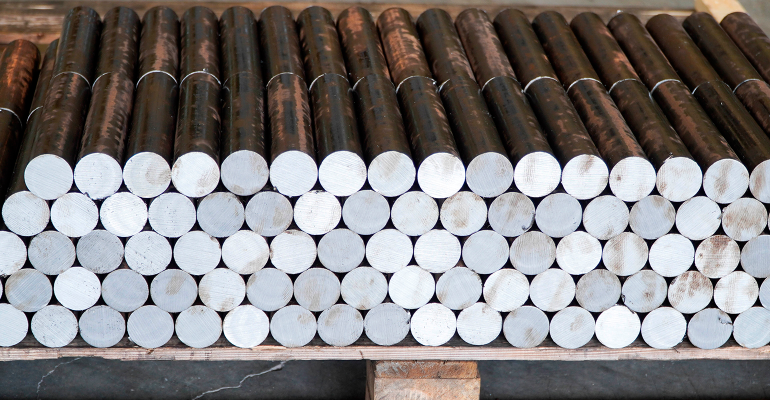

Material costs vary widely. The raw material costs metals can change dramatically depending on the specific metal you choose. As of September 2023, aluminum costs average just over $1 per pound, whereas copper is more than three times as much. And while copper is still relatively affordable, prices vary even more with higher-end metals like titanium.
A CNC machine’s cost-efficiency will only go so far with excessive raw material costs. Some metals also are prone to price volatility, making it difficult to estimate material expenses accurately over a longer period.
Varying machining requirements. Metal production costs include more than just the material’s upfront costs. Some metals are easier to machine than others, affecting the overall cost of manufacturing the product in question. In some cases, that may result in a more expensive raw material being more cost-effective to machine.
A material’s hardness and thermal conductivity are the biggest factors to consider, but other qualities impact the ease of machining, too. While aluminum’s malleability makes it easy to cut, its low melting point makes it susceptible to fusing and warping during high-intensity machining. Steel may be harder and more expensive upfront, but is more resistant to those issues.
Recyclability varies. Different CNC machining metals also carry varying recyclability ratings. Machining is a subtractive process, creating some scrap waste regardless of how accurate the cutting may be. However, if you’re using an easily recyclable metal, the chips or turnings may be recyclable to offset future raw materials costs.
U.S. manufacturers recycle 60% of the titanium they process but just 47% of steel and one-third of all copper. Consequently, while titanium costs more upfront, its high recycling rate makes it easier to find cheaper recycled sources. You can also recycle your own titanium scrap too, to drive costs down further.
