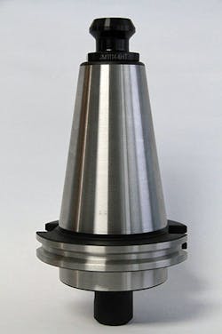

However, despite attention to almost every aspect of the machine, one critical part has been largely overlooked. Namely, the retention knob that attaches to the threaded end of tapered toolholders to engage with the drawbar, which exerts a pull force that holds the toolholder firmly in the spindle.
When tightened, poorly designed retention knobs can bulge the toolholder imperceptibly at the small end of the taper, preventing full contact and proper seating of the toolholder in the spindle. This slows cutting speeds, affects tolerances and precision, shortens tool life and even increases power consumption.

The High Torque retention knob is longer by design to reach deeper into the threaded bore of the toolholder. As a result, all thread engagement occurs in a region of the toolholder where there is a thicker cross-section of material to resist deformation.
The High Torque retention knob also includes a precision pilot to increase rigidity and is balanced by design. Since even over-tightening of the High Torque retention knobs can still create a bulge, the company provides specifically calculated torque specs based on drawbar pressure.
The product works with all existing toolholders including BT, DIN, ISO, and CAT toolholders from 30 to 60 taper.
By combining the High Torque retention knob with the correct torque, spindle contact with the taper is improved to close to 100% every time. This can be verified by simple, six-step “touch off” test. More sophisticated measurement of toolholder expansion (bulge) can also be taken using a taper shank test fixture.
