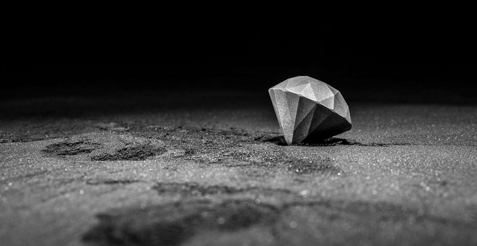

Sandvik Additive Manufacturing recently introduced the first diamond composite product ever to be 3D-printed diamond composite part — demonstrating that super-hard materials can be produced in complex shapes for industrial applications. The diamond was exhibited recently at the RAPID + TCT event in Detroit.

Now, using additive manufacturing and a customized, proprietary post-processing method, Sandvik has arrived at a way to 3D-print diamond composites that can be formed into various shapes.
The difference between Sandvik’s innovation and natural or synthetic diamond is that Sandvik’s is a composite material: Most of the material is diamond, but to make it printable and dense it is cemented into a very hard matrix material, keeping the most important physical properties of pure diamond.
As a result of this (patented) development, diamond components can be created, “application ready” in very complex shapes, with no need for further machining. “Historically, 3D printing in diamond was something that none of us imagined was achievable,” explained Anders Ohlsson, delivery manager at Sandvik Additive Manufacturing.
