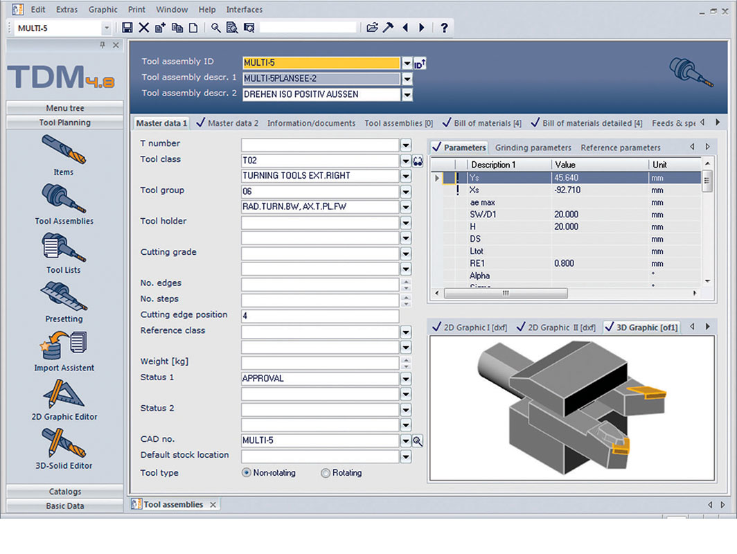

Inefficient tool management is another profit drain. Many plants have improper or inadequate tool tracking processes, so they have difficulty locating tools they need and time gets wasted. Or, sometimes tools are thrown away before their time. To maximize the value of tools, consider using software packages like TDM Systems that help to optimize tool usage and tool life.
