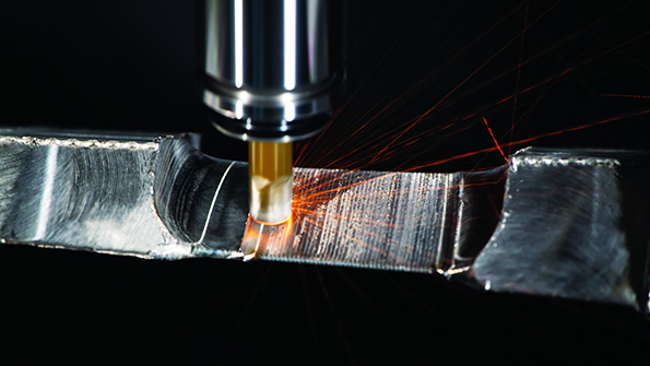

Kennametal’s SiAlON KYS40 4 and 6-flute ceramic end mills are designed to achieve high productivity in tough materials.
The tool was Kennametal’s series of four- and six-flute, high-performance full ceramic end mills. Constructed of SiAlON KYS40 grade ceramic and designed specifically for roughing in nickel-based high-temperature alloys, these end mills often out-produce carbide by up to 20 times. Said Guillon, “We recommend a starting speed of 825 SFM up to 3,300 SFM (250 to 1000 m/min), and feed-rates starting at around 0.001 IPT (0.03 mm), depending on the tool diameter and other conditions. Despite the far higher cutting speeds, we have some customers who have reported two to three times greater tool life than carbide.”

Frieze remained skeptical, though. He’d tried indexable ceramic cutting tools on both milling and turning jobs in the past, with mediocre results. Now, however, he was willing to try anything if it meant meeting the customer’s deadline. When Guillon arrived a few days later with the ceramic end mills, Frieze followed Kennametal’s feed-and-speed recommendations to the letter, crossed his fingers, and pushed cycle start.
“We weren’t certain what would happen so we started out with a block of test material,” he said. “You don’t use cutting fluid with ceramic, only an air blast, and everyone in the shop was crowded around the machine saying, ‘Wow, look at that!’ There was fire shooting everywhere. It was something we’d never seen before. But within the first hour, we knew it was going to work.
The end mill is made from SiAlON KYS40 grade ceramic and designed specifically for roughing in nickel-based high-temperature alloys. The developer’s product manager Matthieu Guillon recommended “a starting speed of 825 SFM up to 3,300 SFM (250 to 1000 m/min), and feed-rates starting at around 0.001 IPT (0.03 mm), depending on the tool diameter and other conditions.”
“The tools aren’t inexpensive,” Stellar’s production manager continued. “At one point, Lori had around $20,000 worth of end mills sitting in her office and we were starting to question the investment. But once we calculated in the machine costs and reduced cycle time, we figured it was three to four times more cost-effective to go this route.
“Each end mill gave us one half-hour of cut time,” Frieze detailed, “at which point we replaced it whether it was worn or not. The process was so predictable we were able to run lights-out. It was a drastic savings.”
