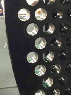

The two parts are Inconel 600 (nickel, chromium, iron) plate, about eight feet in diameter and 1.875-in. thick, to be used as tube sheets in a shell-and-tube heat exchanger, an ideal application for this strong, heat/corrosion resistant material. Each disc must be drilled through with 1,400 1.5-in.-diameter holes, each with two 0.126-in. (wide) x 0.015-in. (deep) grooves milled into the circumference of each bore.
Cambron Engineering drills the two Inconel plates with 1,400 holes each, then must cut two grooves into the bore of each hole.

Cambron machines these parts on a 25-hp Kuraki boring mill, and the interpolated grooving cuts were particularly difficult. "We were using a 3-flute, 0.125-in.-wide groove milling insert that was 0.697-in. in diameter," Christilaw explained. Running at 750 rpm and 9 IPM feedrate with 0.004-in. per tooth engagement, each groove took about 30 seconds – consuming 19 hours of the part's 80-hour machining time. "This didn’t include the operator’s time for in-process measurements, cutter compensation and insert changes," he added.
Milling the two tiny grooves inside each bore consumed 25% of the part's total cycle time when using a three-flute cutter, Cambron's original approach.

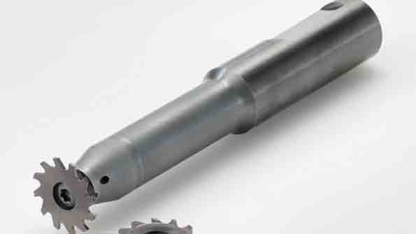

A part of that size and configuration naturally attracts attention when fixtured up, so Horn USA application engineer Brett Kischnick – visiting the shop to handle questions about lathe grooving – asked the operator about it and learned about the tool life and cycle time issues. He later proposed a solution with a Horn 713 12-flute groove-milling insert, 0.854-in. in diameter and 0.118-in. wide. The small differences prove what a “game of inches” machining can be, because the new insert reduced cycle time for each groove from 30 seconds to five seconds.
Here's how: The larger tool diameter – just 0.157-in. larger – reduces the length per cut from 1.830-in. to 1.337-in., about 27%. Increasing the number of cutter teeth from 3 to 12 allows a 400% increase in feedrate from 9 IPM to 36 IPM, while maintaining the same 0.004-in. per tooth engagement.
Bryon Christilaw (right), tool engineer for Cambron Engineering, monitors the work of the new Horn USA 12-flute groove milling cutters with company representative Brett Kischnick.
In addition, the smaller width of the 12-tooth tool (0.118-in. vs. 0.125-in.) leaves 0.008-in. material for the second pass on each groove. This produces a larger chip to minimize heat buildup in the tool, which is amplified when trying to "rub off" 0.001-in. "It is important to have enough stock to produce a good chip to carry the heat away," explained Kischnick. "Otherwise, the tool will absorb more cutting heat. The cooler the tool, the longer it stays sharp." In fact, the 12-tooth tool lasts nearly three times as long as the 3-tooth tool: 45 minutes versus 18 minutes.
The 713 12-tooth milling cutters produce a very smooth cut. They are designed for grooves up to 0.185-in. deep and 0.039-in. to 0.118-in. wide in holes as small as 0.886-in. diameter. They are screwed to the front face of a standard carbide shank, and utilize straight or staggered cutting edges, depending on the width.
