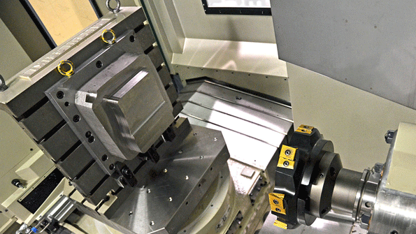

In April 2012, machine-tool builder Mitsui Seiki and tooling and tooling systems developer Kennametal Inc. conducted a test cut on a titanium (Ti-6Al-4V) workpiece on the Mitsui-Seiki HPX63 CNC horizontal machining center, equipped with four Kennametal tools, each using the KM4X 100 spindle connection.

Kennametal noted the KM4X™ represents the next generation of its KM tooling system. Some systems may be able to transmit a considerable amount of torque, but cutting forces also generate bending moments that will exceed the interface’s limits prior to reaching torque limits. By using three-surface contact to improve stability and optimize clamping force distribution and interference fit, KM4X engineering results in three times the bending moment resistant capacity compared to other tool systems.
In the test cut, the HPX63 was equipped with a high-torque, high-power spindle with maximum 26/22 kW power and 1081 Nm torque. The KM4X100 spindle connection generated 85 kNm clamping force, more than twice the effect of an HSK100 and three times that of a BT50 (40 kNm and 25 kNm, respectively.)
The four different cutting tools employed in the test were (1) a 203.2-mm diam. face mill with seven square indexable inserts; (2) the same diameter face mill with seven round inserts; (3) a 76.21-mm diam., 228.6 mm long helical (HARVI Ultra™) cutter, each with five helical rows of 11 inserts; and a flat-bottom, indexable (FBI) drill unit at 125 mm diam., with six indexable inserts.
With the power of the machine tool and spindle and superior clamping force of the spindle connection, test cut results were phenomenal, across the board. For the square-insert face mill, the material-removal rate reached 88.74 cc/min. at 64 min-1 spindle speed, 12 mm depth of cut, and 45 mm cutting width, feeding at 164.3 mm/min.
At 73 min-1 spindle speed, 177.8 mm cutting width, 3 mm depth of cut, and 88.9 mm/min cutting feed, the round insert face mill achieved a 47.42 cc/min. material-removal rate.
The HARVI Ultra™ helical cutter, cutting in X and Y directions simultaneously, topped 309 cc/min. material-removal rate at a spindle speed of 171 min-1, 101.6 mm/min. cutting feed, 40 mm depth of cut, and 76.21 mm cutting width.
The FBI drill made a flat-bottomed hole in the titanium workpiece at 102 min-1 spindle speed, 10.2 mm/min. feed, and 125 mm hole diameter at 125.2 cc/min. material-removal rate. Following the first hole, the workpiece was rotated 45 degrees away from the spindle, and an angled hole was drilled pushing through the edge of the previous hole. In spite of the heavy interrupted cuts, both machine tool and drill performed well.
