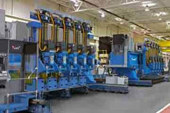

Two MAG XTi profilers are being installed as part of a $100-million expansion at Aerospace Dynamics International in Valencia, Calif. The new machines are designed with 51-kW spindle motors to produce 2,523 Nm of torque.
