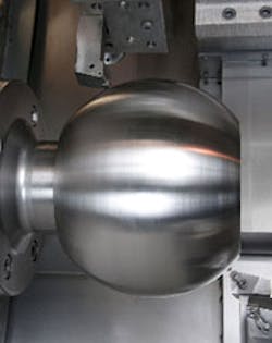

Closeup of ball rough-turning with Ingersoll AS20 SiN ceramic insert. Note the liberal flood cooling, even over the toolholder and insert. This lets the operator start indexing immediately after stopping, without waiting for the insert to cool off enough for handling.

Kippola’s recommendation for both turning and milling: Ingersoll ceramic grade AS20 SiN inserts, running at roughly twice the speed of any other ceramic tried. To Horton’s surprise, the inserts were “unwhiskered” (no microscopic reinforcing fibers), with special edge preparation. Turning inserts are plain rounds, which rough at 1,200 SFM. Milling inserts, seated in a 2-inch shell mill, are notched for better gripping in the seat pocket to withstand the extremely fast rpm’s. Standard speed: 2,500 SFM.

The outcome: a secure process for roughing Inconel, which runs twice as fast as with any other ceramic. For example, turning a ball that used to take an entire shift with carbide, and two hours with other ceramics, now takes an hour. A seat ring that once took an hour with carbide, and 30 minutes with other ceramics, is now completed within 15 minutes.
Some milling jobs feed at 200 IPM @ 2,500 SFM without catastrophic edge failure. Turning feeds up to 0.01 IPR @ 1,200 SFM are routine. “With the other ceramics we tried, whiskered or unwhiskered, the milling was not up to our standards,” said Hub Whitley.

Indeed, heat management in a broader sense helped to shorten cycle times in other ways. Keeping the tools just warm to the touch will shorten indexing downtime to a measurable degree. “We’re deliberately accepting high edge wear in exchange for higher throughput, which necessarily means more frequent indexing,” says Horton. “Naturally we want to avoid indexing delays due to inserts becoming too hot to handle right away.” Kippola added that he has seen processing at other plants delayed for 10 minutes or more, waiting for the tool to cool off enough to handle.
Accordingly, MOGAS flood cools everything during turning ---work piece, mandrel, tool and tool holder. They run the milling dry, but flood the cutter and inserts for 15 seconds at every indexing stoppage. Horton won’t disclose the actual indexing frequency, but says it’s short enough to shock some people. “Nevertheless, we’re way ahead economically by burning through inserts in order to run faster. That’s a trade-off I’d take any day.”
