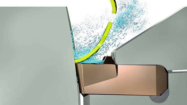

Direct delivery of cutting fluid to the work zone, together with a variety of application-specific chipbreakers, means that Kennametal’s Beyond Evolution™ grooving and cut-off system achieves robust chip control while extending tool life significantly.

Specially designed coolant delivery channels in the Beyond Evolution toolholding system separate and direct cutting fluid to where it’s needed most, underneath the chip and into the work area.

“The Daewoo isn’t equipped with high-pressure cutting fluid, and the standard pump was unable to generate enough pressure for us to utilize coolant through the tool on our old cut-off system,” he explained. “Because of this, we’ve been stuck with flood coolant, and have always had some chip control issues as a result — the chip would roll back on itself and starve the cutting edge of coolant.”
Even without high-pressure coolant, Kennametal’s Beyond Evolution toolholders increased tool life by three to one, compared to EMC’s legacy cut-off system.
