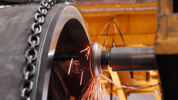

Debottlenecking at Terex
The retooling at Terex began when the plant’s managers started a systematic search for ways to raise throughput, without capital investment. The search quickly centered on the big rough milling operation, since it had become such a bottleneck to the production process.
It is a big roughing job. The parts are transmission boxes, essentially huge tubes big enough to stand in – 9 or 12 ft diam., 8 to 10 feet long, with walls 4.5  to 8 in. thick. The bottleneck operation involves rough-milling about 0.700 in. of Rc32 alloy steel off both ends.
Previously, the process limped along using a conventional 6-inch radial facemill on an older, loose 40-HP horizontal milling machine, taking 3.5 hours to complete each part — and shattering inserts willy-nilly. The operation generated so much machining heat that it vaporized the cutting fluid into fumes, and made the cutter so hot to the touch that it took half an hour to cool off enough for an indexing.
Once again, the solution was to switch to tangential milling with an 8-inch tangential Ingersoll S-MAX facemill. As a result, throughput doubled, sudden insert failures disappeared completely, and tooling costs decreased 90%. “The inserts never suddenly rupture or crack anymore, they just wear out gradually now,” according to Roberto Magallanes, a Terex lead man.
As further proof of more efficient cutting action, the chips are hotter than before, yet the cutter and inserts are just warm to the touch. The heat of cutting is generated in the workpiece metal, to soften it at the cutting point, but then it leaves with the chips.  Based on this success, Terex has standardized on tangential milling for all heavy roughing jobs.
