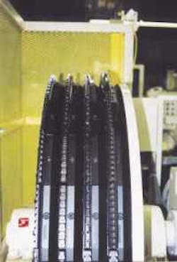

Micrograins increased the tool life of broaches on this machine from 600 to 10,000 hits. In addition, cutting accuracy was improved.
The micrograin substrates used with this rotary broaching machine cut a wrench manufacturers production costs, letting it maintain its U.S. operation.

Spartan recently used Duramet's micrograin-carbide blanks to make tooling for an end user's safety-wrench application. Previously, the end user machined the wrenches with a high-speed steel pull broach and then heat treated. However, the expansion and contraction of the heat-treating process varied, distorting wrench widths. The process also added the cost of a second deburring.
The end user's problems were addressed through a collaborative effort involving Spartan on the tooling side and Lumco Manufacturing Co., Lum, Mich., on the machine tool side. Lumco developed a rotary broaching machine that ensured the wrenches met the desired width after heat treating. The new machine tackled the user's labor and productivity issues; however, the company still had tooling issues with the brittle, heat-treated steel. Slow machining speeds, about 80 sfm, made the proper tooling vital. This is where Spartan came in.
"We needed something with a real strong edge, either a C-2 or a micrograin," says Borden. "And we also wanted a carbide that provided both wear resistance and strength. Because of the slow speeds involved, that meant a micrograin," says Borden. "And by adding a coating, we had the best of both worlds."
The micrograin substrate paid off, providing greater cutting accuracy and longer tool life. "We went from maybe 600 hits on a typical broach to up around 10,000 with the carbide," adds Borden. "The production rate is about the same, 6 or 7-sec cycles, but we get more out of the tooling and eliminate some of the post processing."
