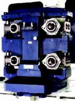

Integral-pallet tombstones combine machine pallet and fixture as one, which gives shops more high-production workholding options because the fixture sits lower in the machine's work zone.

No matter what fixture type, hydraulic or mechanical, it most likely gets mounted to a workholding tombstone. And one tombstone style, in particular, offers several advantages for high-production workholding.
Integral-pallet tombstones combine the machine pallet and fixture as one, instead of the fixture resting on the machine's pallet. Combining the two gives shops more workholding options because the fixture sits lower in the machine's work zone — there's more usable Y-axis space. This type of tombstone eliminates tolerance stacking between a separate pallet and fixture. It also reduces the number of machined surfaces — like the top surface of the pallet and the bottom one on the fixture.
