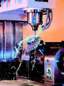

Tilting rotary tables work well for 5-axis machining multiple sides of small, light parts.

At the mention of 5-axis machining, shopowners typically think of large, dedicated, expensive machining centers — fully interpolated for simultaneous cutting motion. But what many shops don't realize is that 5-axis machining is possible on a 3-axis machine by adding a tilting, 2-axis rotary table or spin-dle-head attachment. Probably the easiest and most affordable way shops can take advantage of the benefits of 5-axis machining is by adding a 2-axis, tilting-rotary table to a 3-axis machining center. In this setup, workpieces mount to a platen on the tilting-rotary table, which mounts to the bed of the machine. The table then positions parts at various angles for access to multiple part sides, which is especially useful for machining small, light parts.
The diameter of the platen on a tilting-rotary table places limits on the size and weight of the workpiece that can be mounted on it. Since a rotary table reduces work-envelope space, part size must be considered when selecting a machining center. However, work-envelope space can be maximized by using a machining center with an extended Z axis that increases allowable workpiece height.
