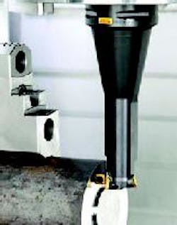

CoroPlex MT from Sandvik Coromant (www.sandvik.com) is a multifunctional tool for finishing workpieces in single setups. It combines with either CoroMill 390 as a rotating tool for milling applications or indexes in a number of optional ...
March 20, 2006
CoroPlex MT from Sandvik Coromant (www.sandvik.com)is a multifunctional tool for finishing workpieces in single setups. It combines with either CoroMill 390 as a rotating tool for milling applications or indexes in a number of optional positions for stationary turning using two different CoroTurn 107 inserts. The tool is for use in almost all insert positions without the support of extra software and works in older machines with software capacity limited to conventional standard cycles.
