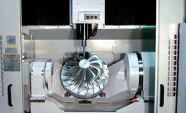

When milling an impeller, scalloping can occur — and that constitutes another major issue with the accuracy of the surfaces. The new algorithm tackles this problem effectively because of its capability to achieve much more accurate five-axis swept volumes. The new five-axis swept volume method allows more flexible quality optimization, which enhances the finishing surface accuracy and performance in terms CPU time and number of faces of the stock after simulation.
