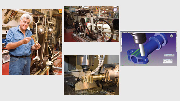

He took various measurements off the old part — approximately 6.5-in. long and 4 in. at its widest, and extrapolated the dimensions for accuracy and symmetry and compensated for the extreme wear that the parts had. He entered geometry into the GibbsCAM program, and from lines and curves he developed a solid model with GibbsCAM Solid Modeling. Then he made modifications to improve aesthetics of the part because it operates in plain sight.
Two thirds of the part is purely cylindrical, so Juchli first turned the part on a lathe, leaving the wide end as a solid block. Then he started programming the part for 4-axis CNC machining.
He oriented the model in GibbsCAM, positioned it for the fourth axis as it would sit on the CNC, and machined the part directly from the model.
“Indexing to machine the ears, or clevises, was the most difficult part, since I don’t use the system but once or twice a month,” Juchli said.
Specifically Oriented Coordinate System
GibbsCAM uses a specifically oriented coordinate system as its reference to control part rotation in machining.
Juchli said that GibbsCAM makes that easy to do with its Advanced Coordinate System that defines a system with whatever planar orientation is needed.
Once that is done, “you position the part and machine it. The coordinate system rotates the part perpendicular to the tool, so you machine in the X-Y plane. I built a standard coordinate system, then one for the slots, and one for each of the two sides. The rest was easy,” Juchli said.
He defined his five tools with the program’s Tools Palette, and machined the part to generate NC code, which he postprocessed for the Fadal. “
However, as an infrequent user, I rely heavily on GibbsCAM Cut Part Rendering for toolpath verification, even for simple parts. It shows every cut made by the cutting tools. The software constantly amazes me. I discover new things every time I use it,” he said.
Satisfied with the project, Juchli said the end result, the shop’s first 4-axis part, looks and works beautifully.
